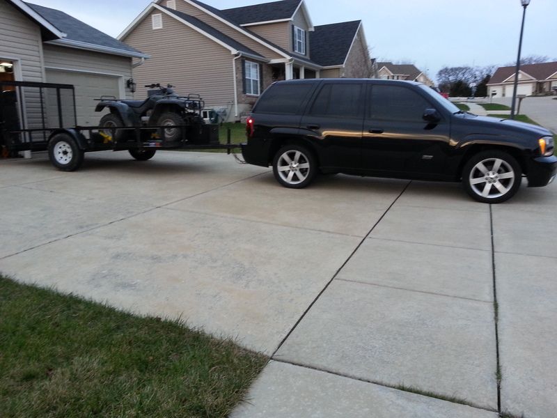

Alright, so i picked up my TBSS with the intention of it being a family and toy hauler. Its hard to get the lady, kid and dogs in an extended cab S10.
I have a 18' aluminum bass tracker. its light, dont know the exact weight, but i could easily tow it with the v8 s10 in OD without worry. i also have a 16' utility trailer that is used to haul everything that wont fit in a truck bed. I do tow frequently. The boat stayed hooked to the truck almost all summer. we were on the water 75% of weekends.

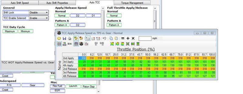

It's harder to feel with a stock converter but lock up almost feels like an additional gear that drops the engine speed a little and makes it feel a little more firm - as if it's a manual transmission. Like I said its harder to tell the difference with a stock converter because it has such a low stall speed.
With your load, any converter should not have an problem locking up and unless there is an issue with your truck I'm sure it's locking up just fine.

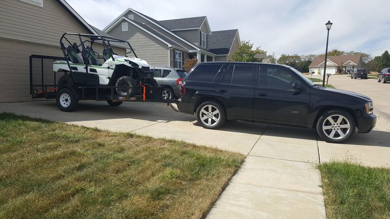

bumping this back to the top. After picking up a side by side, all my tow vehicles struggle. this thing is like a giant sail behind the truck and provides some serious drag, it got even worse after i added the windshield to the SXS. couple that with all the gear we typically drag along it strains the cooling system. it wasnt uncommon to see 220* water temps even with cool ambient temps.
i picked up and FSR radiator, 160* thermostat and added the pusher fan to my PCM of nc trans cooler.
still need to install the radiator and the stat. but my cooling should be fine after all these goodies go in.
