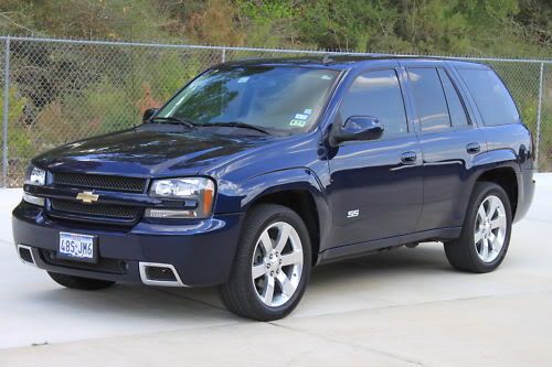

Been looking at tires and have a few questions that maybe some of you guys can help with. What are the advantages or disadvantages with going with a different size tore than stock? I know the 265/50's are a little taller and wider but what about the 275/45's? Which offers a better ride, performance, etc. and are there any speedo issues with changing sizes? If we can't get the 20x10 polished reps made soon I'm going to need new tires and can't decide. Here is my truck btw. Stock for now (cutout on the way!)

The 275/45 is a little wider and shorter then stock and the 265/50 is a little wider and taller then stock. They both work good on an 8-9" wheel.
For the 10" wheel I like the 295/45/20
I know it boils down to opinion but what looks better on a stock height tbss? I've heard some people on here say the 265 looks too big. I know the lower profile looks sportier to me but also might look wierd if I don't lower. I guess I just need to see some in person lol.
