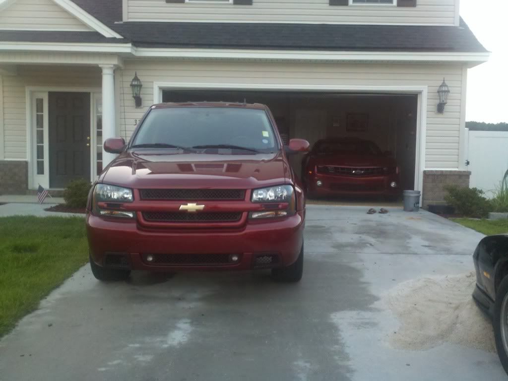

hey guys and girls. I got my TBSS a couple of months ago and somebody had already painted the air ducts flat black, It was a crappy tape job they did and i'd like to get it all cleaned up and chrome again without messing up my RJT. Is there something safe i could use that will remore spray paint but not hurt the clearcoat paint on the truck?
