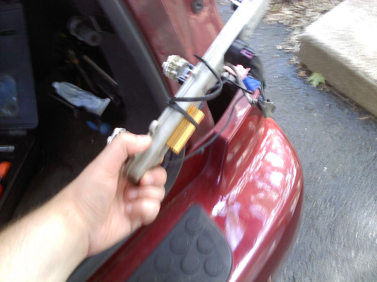

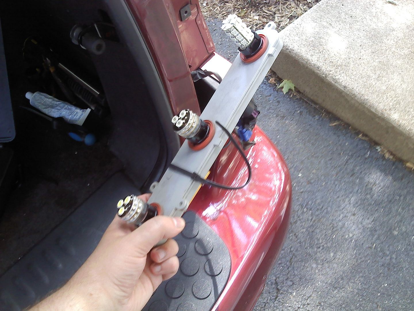

Crappy phone pic I took, zip tie it to the back of the circuit board, tap it into the black wire and the blue wire next to the brown wire.
See less See more
2
Pics of connection if you can my friend
just tap it where he said. I'd personally solder the connection points and tape it up when done.
Don't have any close up pics of the wire, but see the blue thingy in the background? It should come with it, just place it over the wires I said and put the end of the resistor in there, clamp down with some pliers, maybe wrap a little tape over it just for good measure and it's done.
