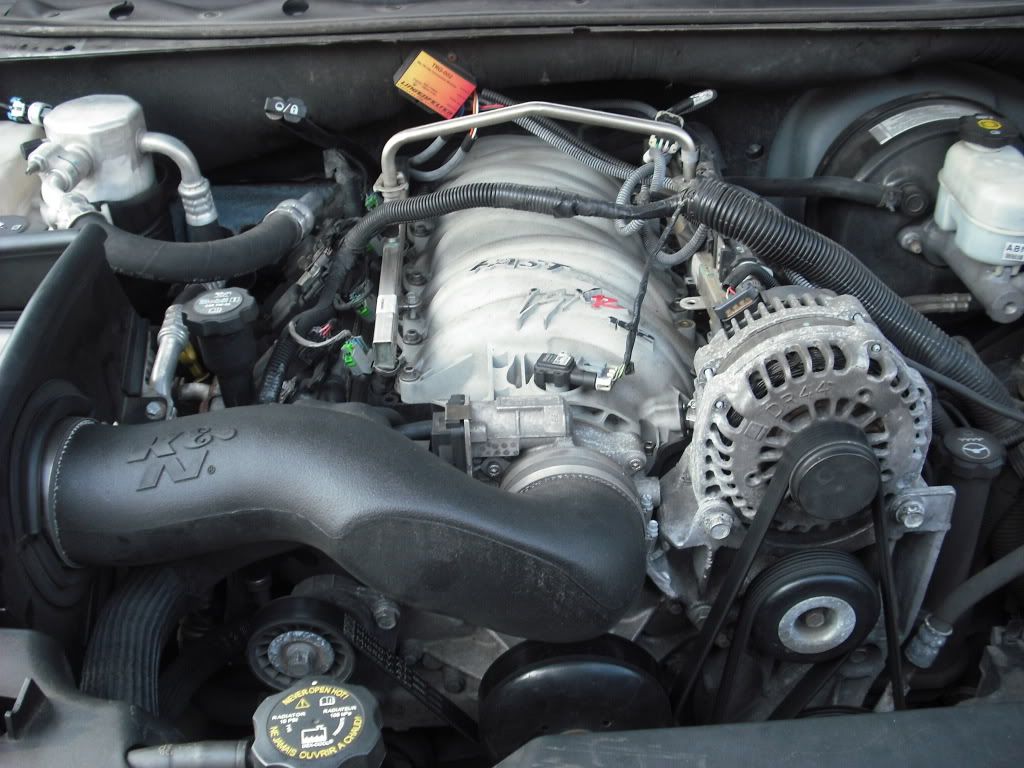

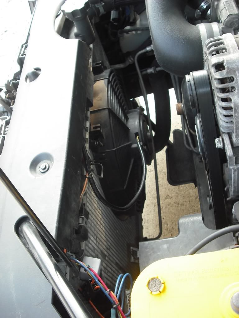

I purchased a TBSS with some mod.'s already on it. K and N filter, fast 102 intake, it has a tune but am no sure where it is from.... It has an e-fan I am having trouble with. It keeps running at high temps. while in traffic. The fan and wiring harness appears to have been purchased at Auto Zone or Advanced Auto. I do not know much about the setup and would like some help if anyone is willing to give it.
4,849 Posts
That fan seems to be small, get your hands on the spal fans or the ls1 efans and contact Alvin at pcmforless.
