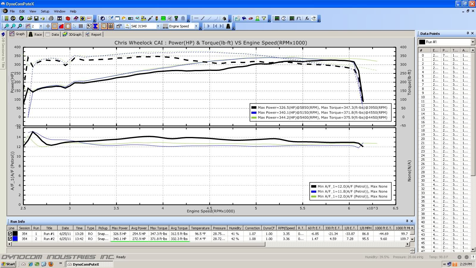

Scary how lean it was at around 4k rpm where it picked up a whopping 62 ftlbs of torque, huge SOTP difference! It ran a [email protected] in 900ft DA untuned so hoping with the the increased power and faster shift speed it should be ~.3/3mph faster. Will have to wait for cooler weather to find out, only problem is I'll probably be swapping to 3.42 gears before then so it'll probably be a wash. Eventually I plan on putting my sleeper cam and headers on it to see if it'll break 400 and run 12s.

nice little tune......:popcorn3:

Sorry, I looked at the air temps and humidity....Ouch!
The 3.43 IMO will Hurt your times. I like the numbers you put down!

Thanks, graph is SAE smoothing 1. The 60' I'm sure will suffer, but I think it actually might be a wash in 1/4 ET as I'll be right at the top of 2nd with the 3.42s, so I'll only be making 1 shift instead of 2.
