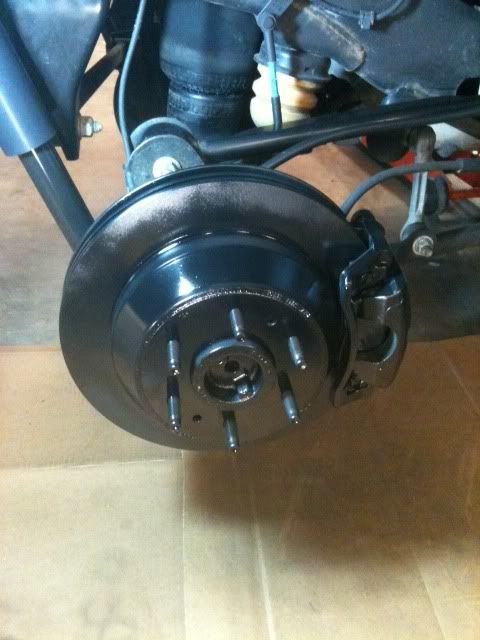

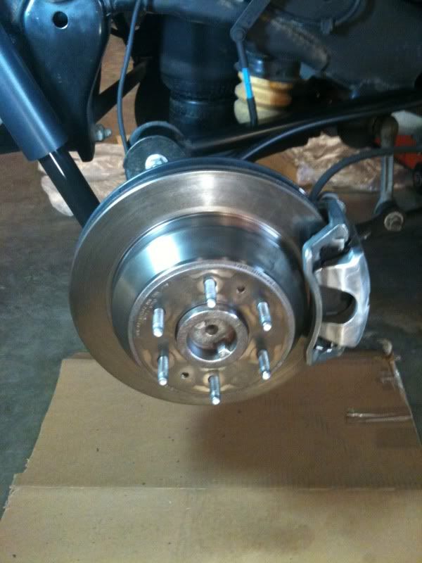

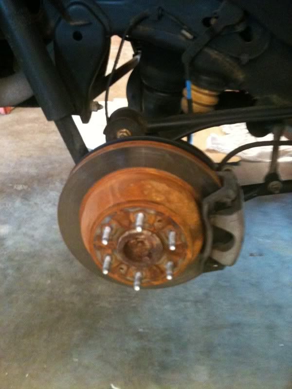

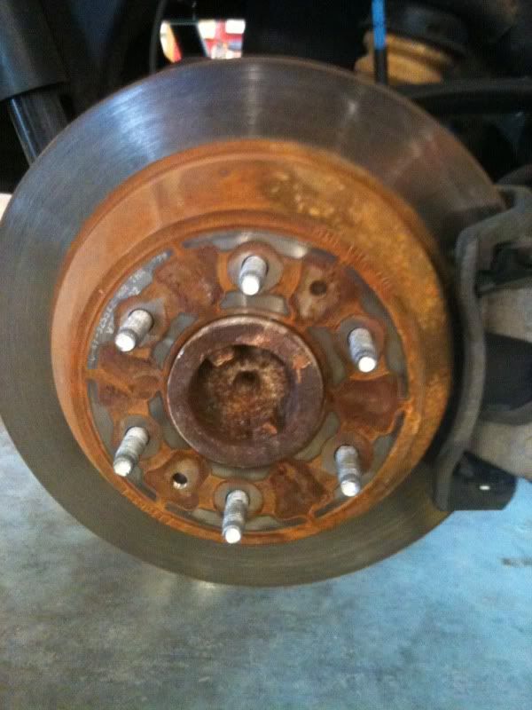

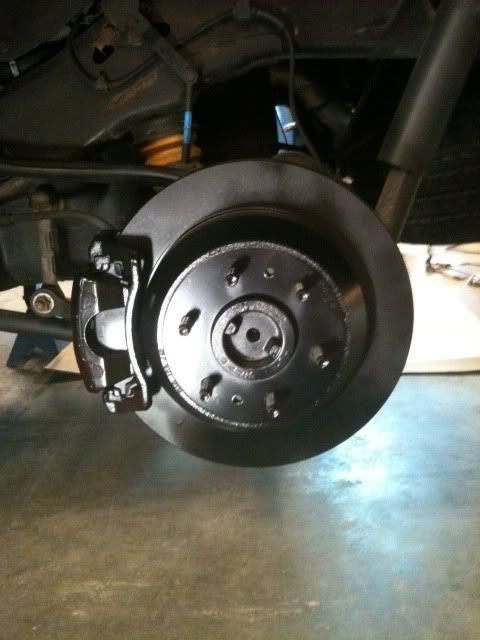

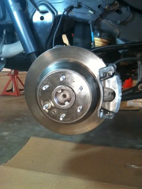

SO, my brake rotors and calipers were pretty disgusting, the rotors more than the calipers but i wanted to paint the calipers anyways...
I started with a wire wheel brush drill bit (works miracles) and brushed the SHIT out of them. Then used gratuitous amounts of brake cleaner and 1 thousand shop rags. And Finally put on 3 coats of VHT BLACK Caliper paint. Didn't really tape anything off or mask anything figures the pads making contact with the rotors would clear a path of silver to shine through again (and it did). Final product.... it looks great! Well see how long this holds up as its only been like 3 weeks since i did it. but here are some before and after pics..
BEFORE
DURING
AFTER
