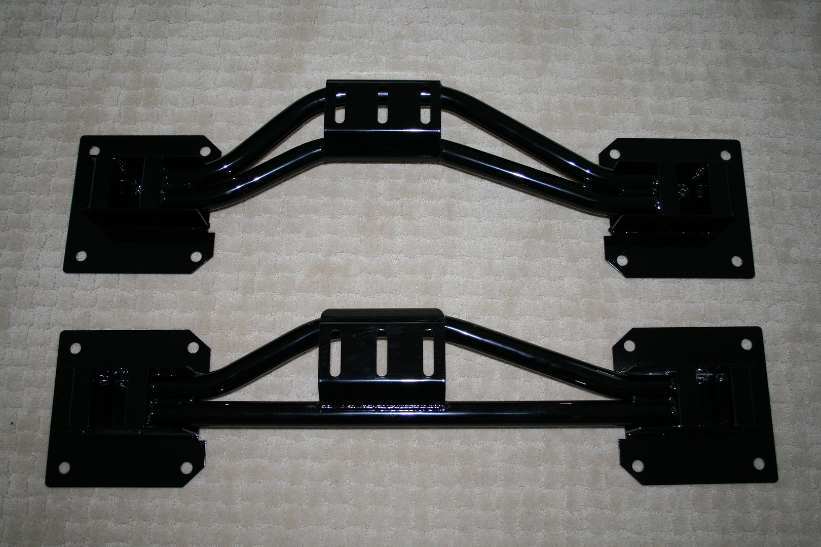

Here are pictures of the full package with spacers and powdercoated crossmember. The second set of pictures is of a comparison between the 2WD and AWD crossmembers.
Contents of the 4L80E Conversion Package
1. 4L80E Conversion Crossmember
2. 4L80E Conversion Mount Spacers (2x 1/4" and 4x 1/8")
3. 4L80E Conversion Cooler Lines
4. 4L80E Conversion Cooler Line Adapters (1999 + 4L80E Case)
5. 4L80E Conversion Harness
6. 4L80E Conversion TCM (Preprogrammed)
4L80E Conversion Package Pictures After Powdercoat
4L80E 2WD (Top) and AWD (bottom) Crosssmember Comparison

The spacers in the kit are for the mount, this way you can dial in the driveline angle.
Phoenix Transmission is making the Conversion for the AWD. You will need both Phoenix Transmission and LC32 Conversion Packages for an AWD. With the parts from Phoenix you will be able to bolt a 4L80E to the stock Transfer Case.

I just got off the phone with Greg at Phoenix Transmission.
We are going to have to build another fixture for the AWD TBSS's. The mount needs to mover for the adapters.
We should have the new fixture and AWD crossmembers finished the week after the 2WD kits start shipping.
