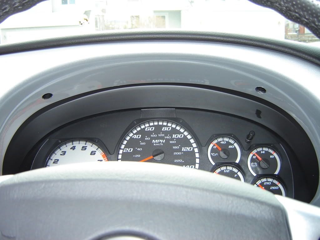

Installed molded dash kit today. Biggest complaint is that they do not put the holes in above the gauges. Had to customize myself. Had to remove bezel line up dash kit and drill with small drill bit from the back. WARNING to anyone who purchases this kit and does this do not jump straight to the finale drill bit size, plastic is to thin and wants to tear. Ended up heating the side of the drill bit that goes in the drill with a candle and pushing it through. Trimmed rough edges with razor blade. Right and center gauges a little snug but worth in IMO. Thinking of getting the little plug things for when you take off the license plate bracket to cover holes. In a perfect world it would never need to come apart again but I want stainless gauges at some point.
