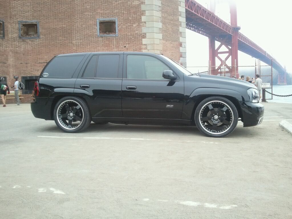

Son approves!! Cruized around the city today got lots of thumbs up. I missed that cam chopin thats for sure.
Wheels are True Forged Sleepers
22x9 front 285 35 22
22x10 rear 305 35 22
FRONT SUSPENSION
My Modified DJM Upper a arms
Kbee Coilovers
REAR SUSPENSION
Rear Belltech TB Springs
Belltech Rear Street Performance Shocks
SPOHN upper/lower adjustable a arms
SPOHN panhard bar
Airlift Wireless Air
Airlift Coilspring Helper Bags
Rear DJM Swaybar
Thumps up from who? Your son? That's not thumbs up worthy :bum: j.k looks good

Like how it sits..how low is that an u awd? Clean look..
djm 2 inch front drop kit plus kbee coilovers
rear spohn kit with belltech shocks and belltech cut springs
on 285 35 22 front is 30.25 from ground to fendelrip
on 305 35 22 rear is 30.75 from ground to fenderlip

Truck looks good Tony! The little man is growing like crazy!

That is really a super looking TBSS Tony! Good work and paying attention to detail.
